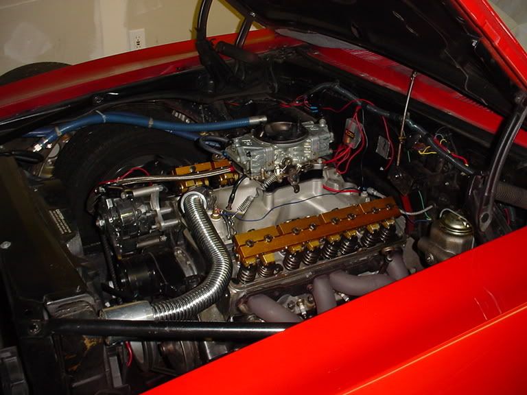

so I was driving back from the local friday night get together, and to much horror I glanced at the oil pressure guage to see a big fat 0. I immediatly shut the motor off got out and checked the oil. Plenty there, turned the motor over again and had full oil pressure... happend again 5 minuties later. I installed another oil pressure gauge and the same thing happened...the new gauge is more accurate and shows a minium of 7psi. I think I have a problem in the oil pump bypass, anyone have any other thoughts? I am running a Melling 55HV oil pump in a 406 SBC.

Thanks Eric, we will be pulling the pan on Thursday night and replacing the pump, seems to me to be the most likly cause, I don't think the oil pressure did hit zero because when we swithched to aother gauge and line the pressure bottomed out at 7 to 9 psi. the second gauge is a 0 to 80psi while the dash gauge is a 0 to 100psi unit. We will also be able to check the oil pikup at that time.
